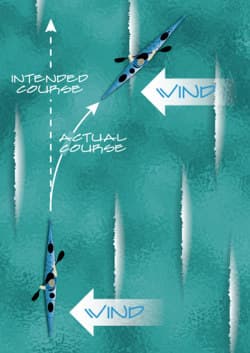

So, you've learned and practiced all the basic strokes: the forward, the sweep, the stern rudder, the draws and the braces. But any paddler who's been out in the wind and the waves and all that other wet and wild stuff has at some point observed that when floating stationary in the water, most kayaks—with or without a paddler aboard—will tend to turn sideways to the wind, lying parallel to the waves. But while underway and paddling across the wind, most will tend to gradually turn upwind to point their bows nearly into the wind, or within 30-45 degrees. This tendency is a function of several physical forces acting on the boat, each of which we'll explore a bit, but the upshot is that this phenomenon can make it difficult to keep your boat on your intended course, and can be frustrating and physically exhausting for an unprepared paddler, especially if one doesn't fully understand its cause.

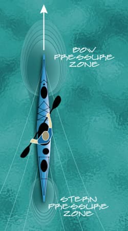

 Every vessel, whether an oceangoing freighter or a little plastic kayak, creates a pressure wave footprint with a distinctive shape as it passes through the water. When viewed from above, bulbous zones of high pressure surround the ends of the boat (larger at the bow and smaller at the stern), while a narrow zone of low pressure suction pinches the midsection. The precise size and shape of this footprint will vary with speed and hull shape, but it is these pressure zones, moving along through the water with the kayak, which create the bow and stern wakes.
Normally, these pressure zones are symmetrically balanced on the left and right sides of the hull, so the kayak tends to track straight. But when paddling across the wind, the beam wind exerts a sideways, lateral force along the entire length of one side of the boat. Because the larger high-pressure zone surrounding the bow serves to resist this lateral force, and the smaller high-pressure zone around the stern offers less resistance, the overall effect is that the beam wind is able to push the stern further off course than the bow. The resulting force tends to push the stern downwind, and the bow upwind—the familiar weathercocking phenomenon. Because the entire pressure footprint is amplified by speed, and dissipates when the kayak glides to a stop, weathercocking tends to increase the faster you paddle.
