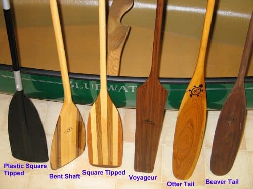

Beaver Tail Paddle
 For general use, that being a trip that takes you from lake to lake, the old-fashioned Beaver Tail design works great. It's made from a solid piece of wood (usually maple, ash or cherry) and has a rounded end to it, like that of a beaver's tail. It's a great paddle to use for flat water tripping, especially at the bow.
Otter Tail Paddle
For use in the stern, or especially solo paddling, the Otter tail is preferred. It's similar in design to that of the Beaver Tail but extended somewhat, has a narrower blade towards the tip, and has a shorter shaft length.

Whitewater Paddles
For whitewater paddling you need a much wider, square tipped blade to enable you to push lots of water in a real hurry. The previously mentioned touring blades are actually far more efficient when it comes to pushing water for the long term. Most of the blade length is under the surface and less friction occurs. The rounded tip also enters the water more easily. But to muscle your way across its far better to have a much bigger blade. It should also have reinforced tips to protect the paddle from sharp rocks. And for capital control the top of the paddle should have a T-grip. Avid whitewater enthusiasts also opt for synthetic paddles made from fiberglass, graphite, Kevlar, or plastic. They're tougher than wood, but are also ugly as sin and take away the whole mystique of paddling. A laminated softwood paddle works just as well if you look after it.
Bent-Shaft Paddle
