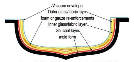

Since construction techniques are basically the same, boats made of what we commonly know as “fiberglass”, those made of aramid fabric (think Kevlar™) and graphite fibers, are all variations of synthetic fabric construction. Built by layering these fabrics either upon themselves or blended with others, they are then applied to a mold. Fiberglass boat molds include an outer layer of colored gel-coating that will form the surface layer of the finished kayak.
Foams panels and/or gauze are sometimes added for reinforcement in the deck and hull. The entire series of layers in the mold are vacuum bagged and allowed to cure to form either a deck or hull section separately. Those two ‘halves’ are then joined together to form the complete kayak.

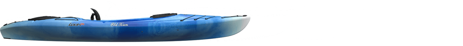

Rotomolded Kayaks
Rotomold Kayak
(Example: Old Town Loon 126)

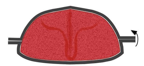

Plastic (polyethylene) powder is poured into a mold, heated and rotated to form a complete, one-piece kayak. Boats are made mostly out of a linear-based molecular structure while others are made from cross-linked poly molecules.
Pros/Cons of Rotomolded Kayaks
These are the least expensive but the heaviest boats among your options. The quality of the plastic used in their construction will affect the weight somewhat, and also the price. Expect the big hogs sold at discount houses to be beasts when it comes to weight as well as trying to wrestle them through the water. Rotomolds aren’t as fine-lined as other options, but some are nearly comparable in performance; they will weigh more, while costing significantly less.
Roto’s are resilient boats, excellent for rocky waterways, taking a rebound with little negative affect. That said, scratches leave minute fuzzies and curl-outs along the hull (affecting speed) and should you puncture or rupture the hull, repairs can be a real problem. Rotomolds are also damaged by exposure to UV and require that you apply protective coatings to the deck and hull.
This type of plastic boat also tends to “oil can” - a depression in the hull or deck area caused by excessive pressure or sag due to the softening of the plastic from extended exposure to the sun or other heat sources - or even being secured too tightly on a narrow, hard roof/storage rack. Most of the time, these depressions will diminish or disappear when brought away from the sun/heat or other stress. Otherwise there are processes one can use to bring the shape back.

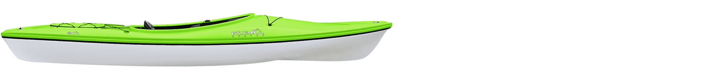

Thermoform Kayaks
Thermoform Kayak
(Example: Delta 10AR)
A sheet of ABS (like a plastic alloy with styrene) with a top layer of acrylic is heated and then drawn down onto a mold (as opposed to forming inside the mold as are powered/pellet plastics) to create both hull and deck in separate operations that are then joined together in a process similar to fiber composite boats.
Pros/Cons of Thermoform Kayaks
Imagine a kayak nearly as light as a composite, with the durability close to that of a rotomold and at a price floating towards the lower end between the two -  and a thermoform kayak should come into mental view. The bright, lustrous shine of the deck/hull and the numerous color choices make a thermoform boat a popular choice for many paddlers.
Thermoform boats usually have UV protection in the outer layer. This form of plastic tends to deteriorate over an extended period of time, but unlike other plastic boats, thermoforms are generally recyclable.

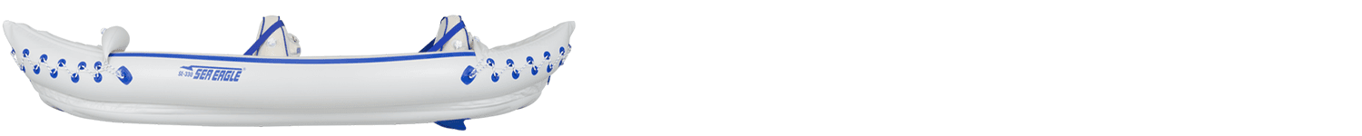

Inflatables/folding Kayaks
Inflatable Kayak
(Example: Sea Eagle SE-330)
Briefly, inflatables are just that - kayak-socks made from strong poly’-based fabric to provide shape and rigidity throughout the boat. Drop-stitch construction enables higher inflation pressures that in turn give the hull/deck their strength integrity. Folding boats are typically canvas or nylon skins stretched over wood or aluminum frames. New technology has also enabled designers to use interlocking panels and fold patterns to create strong folding kayaks.
Pros/Cons of Inflatables/folding Kayaks
Popular among many paddlers who like to carry their boat with them on when the travel, and/or those who have little storage space for a full size/length kayak. Material-size, the nylon decks and hypalon hulls of the class wood or aluminum-framed folding boats are nearly as bombproof as their hard-shell cousins, and typically come with their own repair kits. Other forms of folding boats have also entered the “folding” kayak market and offer lightweight traveling/storing options as  well.
Folding kayaks tend to cost more than their rigid fiberglass counterparts. Modern folding kayaks are as sleek and nearly as rigid as hardshells. They are just slightly more susceptible to punctures. They also require more maintenance because of all the framework components. Another point to consider is how often do you intend to paddle? Do you leave the boat assembled for daily or weekly use, or do you put it together and take it back apart after each occasional paddle? How often do you intend to travel with it?
Inflatables also have the advantage of travel-worthiness and storage options.  These tend to come in a broad range of sophisticated designs and complexity - from inexpensive tubes held together into the shape of a kayak/canoe to baffled air bladders and fused chambers that provide strength and shape integrity when inflated.
Of course, since the rigidity and ultimate seaworthiness of an inflated craft is totally dependent upon air, punctures are critically serious.  Most inflatables tend to be beamy, too, limiting their performance to narrower applications. Despite their beaminess, they don’t always have much room for gear stowage.

Fiberglass, Aramid (Kevlar) or Graphite kayaks (deck and hull) are formed from layers of fabric and strengthening material, resin and gelcoat, then vacuum cured a mold.

Polyethylene pellets/powder within a kayak mold are heated and rotated to create a plastic kayak shell in one piece.
