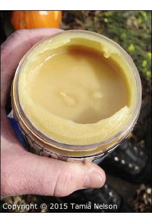

To begin with, here's a brand‑new jar of Sno‑Seal:
It has the appearance and consistency of peanut butter — albeit a rather etiolated peanut butter. (It doesn't smell anything like peanut butter, however. And I don't think I'd be tempted to put it on a bagel.) The Sno‑Seal of my youth was made of sterner stuff. It often had to be heated just to make it daubable. Today's Sno‑Seal has gotten soft. It's ready for use as is, right out of the jar.

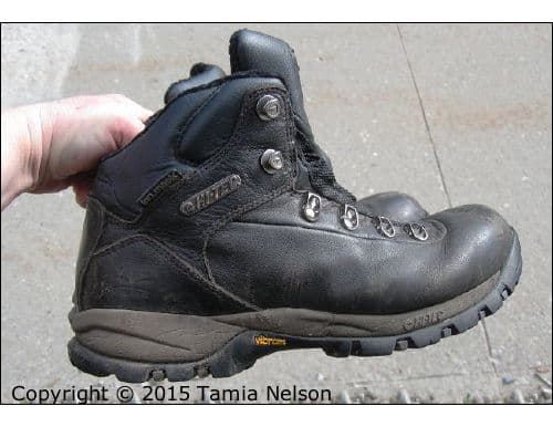

Next, remove the laces. This step is self‑explanatory, I hope. Take the opportunity to inspect your boots for cuts or worn stitching, too:
Notice the number of seams in the uppers of my boots. Back in the day, good‑quality hiking and climbing boots had uppers made from a single piece of leather. (Most also boasted a gusseted tongue and a heel counter-cum-pull‑on loop.) Such boots are still available, but their cost puts them beyond the reach of impecunious hacks. I buy what I can afford, and that means my boots are pieced together from smaller scraps of leather. This isn't a recipe for longevity, but that matters less than it might once have done, since few modern boots can be resoled — and anyway, shoe repair shops have all but vanished from the rural landscape. We're each of us consumers now, after all, and the health of the economy is measured by its throughput. Repairing things is so, well, yesterday. In fact, tossing stuff out before its time is now both a moral imperative and an obligation of citizenship.

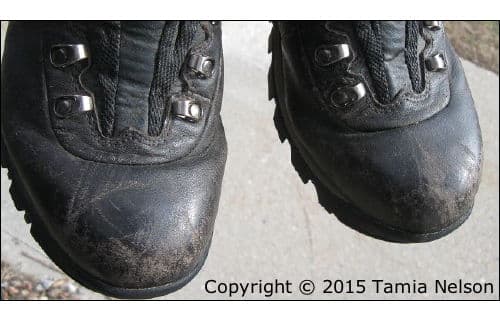

But I digress. My boots are the best I can afford. And keeping the uppers well dubbined will help ensure that they hold together long enough for me to get as much wear as possible from the soles. That's the most I can hope for. So each seam needs special attention every time I Sno‑Seal the uppers — as do these badly scuffed toes:

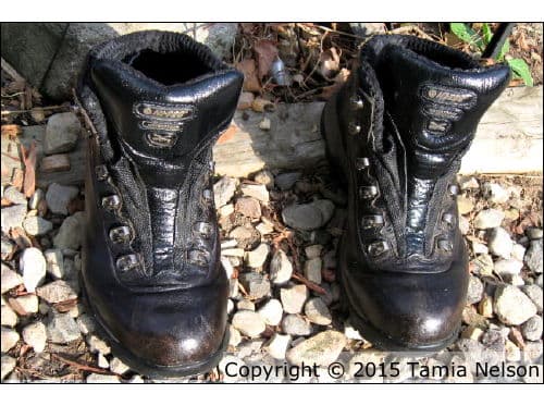

Once I've brushed off all the loose dirt, the next step is easy: I put my boots someplace warm.Warm, mind. Not hot. Whatever else you do, ignore well‑meaning advice to put your boots in the oven to "help the Sno‑Seal soak in." Unless you fancy roasted boot for dinner, that is. The photos I've used to illustrate this article were taken last fall, when I was able to work outside. This isn't really a necessity from an 'elf 'n' safety standpoint. Sno‑Seal is pretty innocuous stuff, and I could have done the job in the kitchen, if I'd wanted to. But the day was pleasant, and I took full advantage of the warm sun and cloudless sky, placing my boots on a gravel apron and letting Sol do his work.
Then, once the boots felt warm to the touch, I gloved up, drawing on my stock of nitrile surgical gloves, kept handy for messy chores like cleaning bicycle chains, fiberglassing boats, and, yes, greasing boots. Strictly speaking, this precaution was also unnecessary. But Sno‑Seal is tenacious stuff — a good thing in a dubbin — and I didn't fancy a Sno‑Seal garnish to my dinner. Now it was just a matter of scooping out a teaspoon‑sized blob of dubbin from the jar and rubbing it onto the upper of the first boot, including the tongue and collar. I gave the numerous seams a little extra attention, into the bargain. And as soon as I'd finished with one boot, I restored it to its place in the sun, then clawed another teaspoon‑sized gob of Sno‑Seal out of the jar and turned my attention to its mate.
The job went quickly, and after letting both boots bask for a few minutes more, I inspected my handiwork, searching for places that still seemed a bit dry. I found a few. They got a second dressing of Sno‑Seal. And that was that. I often overestimate how much dubbin I'll need at some stage in the proceedings, necessitating a quick wipe with a rag to mop up the surplus. (Leaving gobs of excess Sno‑Seal on boots simply attracts and holds dirt.) But this time around I judged the amounts exactly right. There was nothing to mop up. All that remained was for me to don my boots and take a hike down to The River to see what I could see. Which is exactly what I did.
