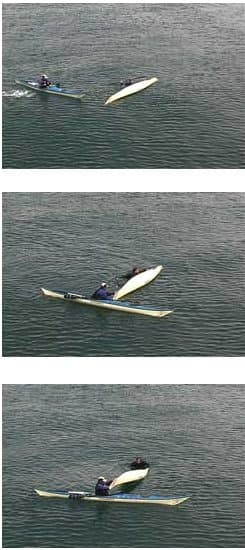

The traditional method (stern drop) uses the weight of the paddler in the water to raise the bow by jumping on the stern of the overturned kayak. This action not only breaks the cockpit seal it also lifts the bow so it can be directed onto the lap of the assisting boater. This requires less effort on the part of the assisting boater, but requires communication and orchestration between the two paddlers.

Instead of using the stern drop to break the seal of the overturned kayak I prefer to use a method I call the bow hook. Your goal is to break the seal without help from your partner.
As many have learned (the hard/wet way), if you just try to lift the bow you can pull yourself over. I have found great stability from the overturned kayak. I actually lean on it and then put my kayak on edge so I can put my cockpit coaming under the end of the overturned kayak as I lift that same kayak. When the end of the kayak is over my coaming, I use a little hip flick to raise the nose up (my cockpit coaming is the lever), which breaks the cockpit seal of the overturned kayak.
Then I continue to lift the bow in order to drain the water as described above. I like this method best because it takes less time and orchestration.
This method can be used to hook either end of the kayak. The pictures here are showing the hook being used on the stern of a kayak that has a drop skeg. In this particular case a TX would have to be used to get the water out. If this method were applied to the bow then a T-drain would be sufficient. Doing a stern hook, when a rudder is present, can get complicated and somewhat dangerous. I strongly suggest you avoid it or else watch those fingers.

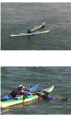

An easier method of breaking the seal and getting the bow over your coaming is using the bow slide. I learned this one from Derek Hutchinson. When you get to the kayak, your first goal is to get the kayak flipped right side up. You can try to do it from the bow by yourself or have the paddler in the water flip it upright while they are at the cockpit. A more time efficient way is to shout out, as you approach, to the paddler in the water to right their kayak before you get to them. The person in the water has better leverage to flip the kayak upright.
This method takes advantage of the bow design to minimize your efforts. With an upright kayak you can use the slope of the bow to slide the kayak up onto your kayak (or lap with a SOT). If deck lines are present the job is even easier (another good reason for deck lines. If you don't have them go out and put them on. The life you save will be your own.
Once the bow is over your coaming let the kayak tilt to the side and the water will begin to drain. I prefer to tilt the kayak (cockpit opening facing my stern) so I can see the water coming out of the cockpit. I continue to lift the bow until the water is out. As before, once the water is out I continue with the rest of the recovery.
