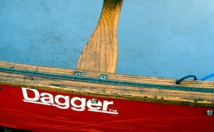

DOUBLE-BOLT THWARTS
The yokes and thwarts of most canoes have a single bolt at each end. This isn't strong enough for a hard working canoe or one that will be portaged very far. Single-bolted yokes and thwarts often twist and split at the ends. The solution is to replace the thick single bolt with two wide-spaced thin ones. Fill the old bolt holes with epoxy before you drill new mounting holes.
