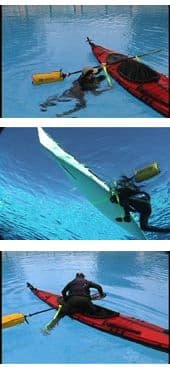

The stirrup cinch method is one commonly used for solo recoveries but can be used during assisted recoveries. The photos seen are from a solo paddle float recovery using a stirrup. We are using them because it is easier to see the stirrup without a second kayak blocking the view. The paddle and stirrup are used in the same manner but there is no need for a paddle float if you have a partner stabilizing your kayak.
The stirrup is looped on one end of the paddle. This is the end closest to the person assisting. In this picture the assisting kayak would be on the side without the paddle float. The paddle is placed on top of the rear deck behind the cockpit coaming. The stirrup goes down from the paddle, between the two kayaks, under the empty kayak and comes up the other side of the kayak to wrap over the other end of the paddle. (In this picture it finally wraps over the paddle shaft on the paddle float side)
After the stirrup wraps around the paddle shaft the remainder of the stirrup hangs down in the water on the side where the paddler is in the water. As before, when you are ready use the stirrup to step up. When you step into the loop, the stirrup cinches the paddle tightly to the kayak.
The length can be adjusted by putting more wraps over the paddle shaft on the side of the swimmer. As you make the last wrap slip the loop on the inside (between the stirrup and the kayak) so the stirrup doesn't slide along the shaft away from the kayak. The closer the stirrup stays to the kayak, the less strain there is on the paddle.
