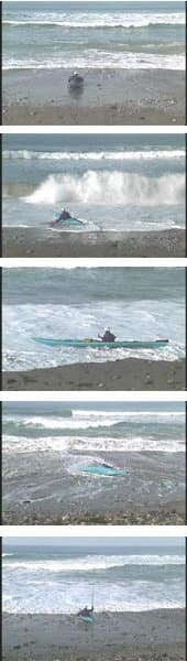

When you are ready and you have stopped moving around, you will need to fully lay your kayak over on it's edge so you can spin your kayak. With your kayak on edge and you laying on the shore, you have the body leverage to spin your kayak. When your kayak is on edge there is the least resistance from the shore, because only a small section of your kayak is in contact with the shore.
In this example, Rod laid towards the water, planted his upper body in the sand and pulled the kayak around by pulling his knees up into the top deck. He is executing a stomach crunch to get the kayak around. In most cases it is usually easier to fall toward the water because of the slope of the beach. It also seems easier for most people to do a stomach crunch to turn the kayak rather than pushing it around (which is shown later in the article).
Even though I think this is a great method it does take some work and you do get dirty in the process. The key to the skill is getting your kayak completely on it's edge.
Remember, your goal is to get your kayak perpendicular to the incoming surge water preferably with your bow pointing toward the water. You can also launch backwards, but if you are going to spin try launching forward. The only reason I would launch backwards is if my kayak ended up spinning around so much I was almost pointing backwards already. This way I have less of a spin. When back in position proceed with your launch.

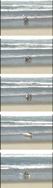

http://www.paddling.com/guidelines/Images/art309push.jpgIn this next sequence, Chuck decides he needs to do a minor adjustment to get his kayak in the correct launching position. He uses his paddle to push off of the sand while throwing his body forcefully to the side to get the kayak on edge.
This can be the hardest part of the skill for those smaller paddlers. If you do not have the upper body weight to get that kayak over on it's side you may have to rock the kayak to help get it over.
I have found throwing your full body weight to the side with both your arms (with your paddle in hand) can help you get over. Your particular kayak design can help or hinder this skill. The more flat your hull design the more you will have to work to get the kayak edged. There are times when the wet sand causes a little suction with the hull making it more difficult to edge the kayak. Rocking can help break that suction.
In this sequence Chuck decided to fall away from the water which means he will most likely push the kayak around. The bow is moving away from his torso as compared to the earlier example where Rod pulled the bow towards his torso. This is an example of trying out both methods to see which one works best for you and your kayak.
Here is a good example of fully edging your kayak. You can see there is only contact with the side edge and the shore. It is interesting how much difference your kayak design can make when trying to perform this skill. I have had some spin easily and others that took a lot of work. The sand consistency is also a big factor.

After Chuck gets to his launching angle he heads toward the water. By using the spin he did not have to get out of his kayak.
