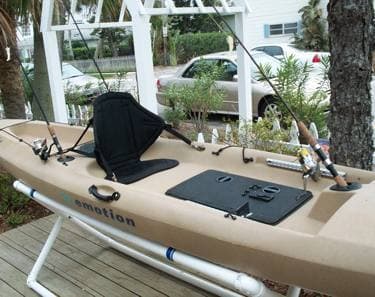

The most common place to install flush mount rod holders is behind the cockpit. The hardest part here is deciding what sort of angle you want to put on them, and then making sure the angle is the same on both sides. Once you determine that, use a marker and, well, mark 'em.

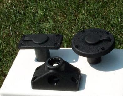

Scotty now offers 3 bases for their rod holders. The 2 on the back are flush mount (2" x 4" base and 4" round base), and the one in the front is a deck mount (2" x 4" base).
The deck mount base only requires 4 holes to be drilled. However, this base is only a good selection if, A) you can get below the base (inside the kayak) to put nuts on to the screws, and B) you don't mind the base sticking up from your kayak. I'm a big fan of the flush mount bases since they can be installed using rivets and they don't get in the way when transporting the kayak.
