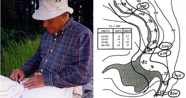

  1. First, draw (use a highlighter) a broad line along each side of the river, parallel to your route. This helps you “keep your eye on the road” while you paddle (see practice map).
  2. Mark the miles from beginning to end. I mark each mile on 1:50,000 scale (1 inch = 1.25 miles) maps and every 4 miles on 1:250,000 scale (1 inch = 4 miles) maps. Mile zero can be at the start or the end—your call. I prefer to start numbering from the end: that way, I can tell at a glance the number of miles that are left to go.
    Now, take a hard look at your numbers: Are you too ambitious? The rule on northern routes is 15 miles a day, plus one "down day" in five for bad weather and the unexpected. Now, into my seventies, I think 10 miles a day is a better plan.
  3. Mark all potential dangers (falls, rapids, dams etc.) that are indicated on the map. Then make a river profile to see how much the river drops per mile.
  4. The contour interval (CI)-- or vertical distance between contour lines-- is given in the lower map margin. It equals 100 feet on the practice map pictured below (Figure 2-1 from my book, CANOEING WILD RIVERS, 5th Edition). This means the river drops 100 feet for every contour line that intersects it.
  5. Draw an arrow at every point a contour line crosses the river. Write the elevation of the contour next to the arrow, and circle it. The 800, 700 and 600 foot contours, etc. are circled on the practice map.
Make a table like the one illustrated (above), and enter the data. Example: The 800 foot contour line crosses the river at mile 63. The next contour (700 feet) crosses at mile 69. It's 6 miles from mile 63 to 69. Thus, the river drops 100 feet (800’-700’=100’) in 6 miles. Divide 100’ by 6 and you get 17 ft. per mile of drop over this distance.
To continue: The 600 foot contour crosses at mile 83. From mile 69 (the 700' contour) to mile 83 (600' contour) = 14 miles. Divide the 100 foot drop by 14 miles and you get a drop of 7 feet per mile.
