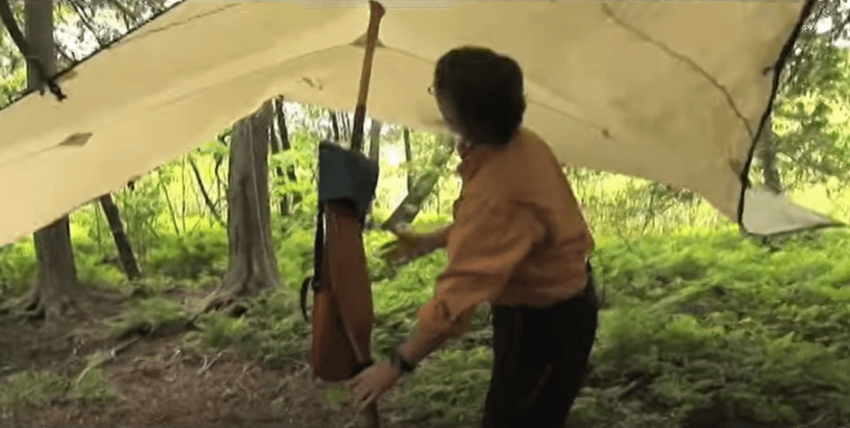

Tarp Shape: Lean-To
The most common shape the tarp should be placed in is a "lean-to" style. This consists of having two ends placed up high, preferably attached to a rope strung between two trees, and the other two placed low to the ground, towards the prevailing winds. Make sure it's snug or the tarp will flop around in the wind and irritate you to no end throughout the night. I've attached small bungee cords on each corner grommet to help keep the ropes tight.
Keeping the Tarp Taught
A center pole also helps keep the tarp taunt. However, rather than searching all over for a tree limb to place in the center of the tarp, purchase a paddle strap - a device that allows two paddles to be attached together. Or better yet, throw a center line up over a high branch and "pull" the center up from the top rather then hold it up from the bottom.
Two canoe paddles strapped together

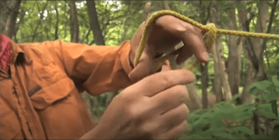

Knots for Putting Up a Tarp
Also, to keep things taught, you need to know two key knots:
Trucker's Hitch:
This is the ultimate combination of a knot and pulley system. It's a great way to rig rain tarps and tent guy ropes or just tighten up a cloths line. The best use, however, is to cinch down your canoe or kayak on top of your vehicle. First, tie off the rope onto the roof rack on one side of the load. Then, about three quarters along, twist the rope to form a loop and bring the loose end of the rope through the loop to form a second loop. Take note that the higher up you make the loop, the more powerful the hitch will be. Now, pass the rope around the other side of the roof rack and bring it back through the loop. Pull and hold down the grip by finishing off with a half hitch.
Trucker's Hitch
Taut-Line Hitch:
This hitch knot is generally used to tie down and adjust the tension on a tent rope when attached to a tent peg. The knot forms a loop that can be easily adjusted by sliding up and down the main line. Start by pulling the free end around the object and placing it under the standing end. Now, wrap the free end around the standing end. Wrap it a second time. To cinch it off, bring the free end back to the standing line, placing it on top of the rope and just in front of the first wrap. Now, make a half hitch by tucking the free end under the loop you formed and pull to tighten.
