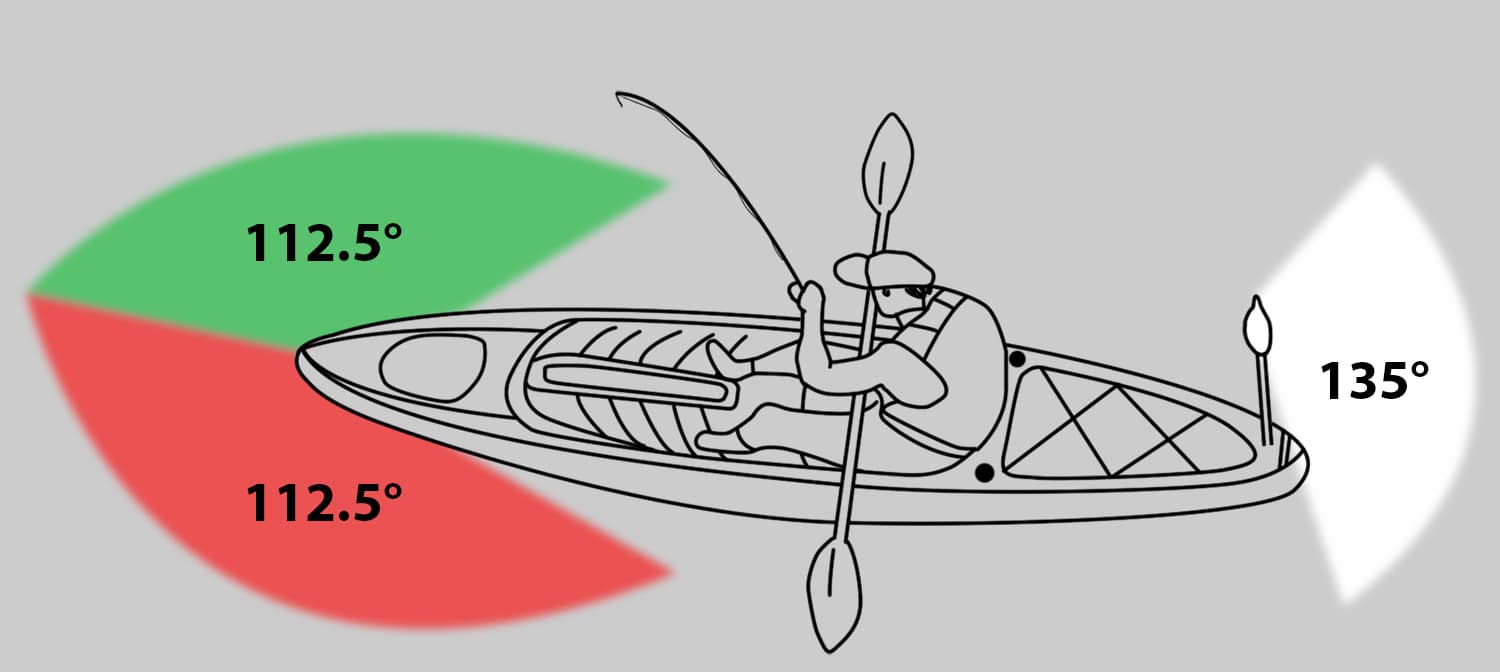

1. Red & Green Sidelights + 135 Degree White Stern Light
Having red and green sidelights (some people call them bow lights or running lights) displaying over an arc of visibility of 112.5 degrees each, in concert with a white 135 degree stern light.

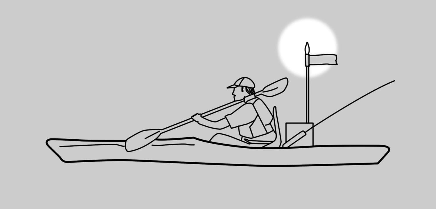

2. 360 Degree White Light
Using a 360 degree white light. (Not an Option in international waters)

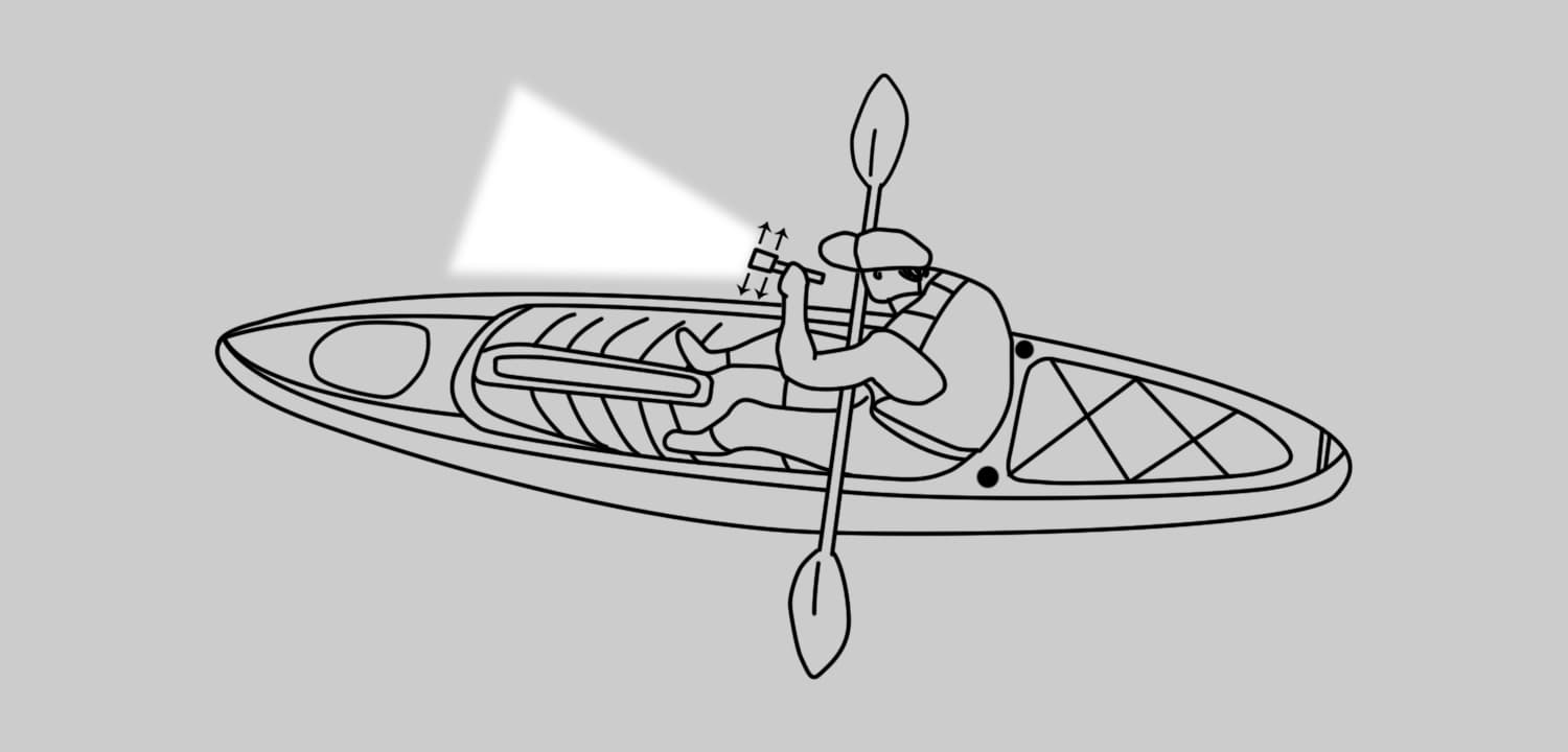

3. Flashlight
Having a flashlight ready at hand and displaying it in time to prevent collision.
