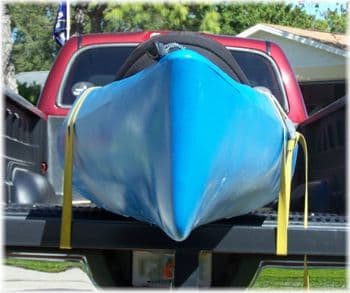

We'll start at the end, the result. This is how the finished product should look.
Strap should be perpendicular to the crossbar. If the strap somehow moved (not likely), it could only get tighter. The strap needs to be snug, that's all you need. Finally, the tag end should be in a snug knot. This will give you a bit of security should the cam slip (not likely). If you're using a roof rack, you'll simply perform this procedure on each crossbar. NOTE: This is a 9' strap. I discovered that a 6' strap is too short.

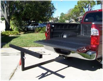

My last truck was a Ford Ranger. Because the truck was so small and low, the rack was low enough so that 2 people could easily load the boats on to it. The new truck is a Tundra (that's right, a truckers truck) - much bigger and a lot taller. A buddy of mine has a rack system for his Tundra, and he has to carry a small step ladder so he can load and lash his boats. I opted for a different solution - the bed extender.
Not much to it, but it makes loading and unloading a breeze. You can find them on sale from time to time for $25, regular price is $40- $50. I've spent a lot more money on things that didn't give me this type of reward.
The main downside to this type of boat transportation is having something that long sticking out of the back of your truck bed. With the Ranger, I once had someone run in to my boat while it was loaded in this manner (though it did have a flag on it). The guy said "he didn't see it". You're gonna tell me you don't see a red flag hanging off the back of a 15 foot long bright yellow boat in broad daylight? Sheesh. The bed extender came with the red flag you see above. In FL, to be legal, you just need to have a flag marking the end and width of the load. It's common here to see the flag hanging off of the end of the boat, and I've never heard of anyone getting popped for just that. The "T" bar can be raised a good bit so you can clear the bumpers of the idiots behind you. Yes, the new target is now their windshield. Natural selection, if you ask me.
The upsides include ease of loading, and no salt water drips and sulfur laden mud falling (and drying) on your hood and windshield during the ride home. I normally load my boat stern forward, so that I can put my rods and paddle in the bow hatch while the boat is loaded. I also transport with the seat on since I carry the boat deck up. See, another time saver. Since the bed extender will fit a standard square tube trailer hitch mount, it's transferable to other vehicles with the slip of a pin. When my buddy borrowed my boat, he also borrowed the bed extender. That made his day a lot easier too.
