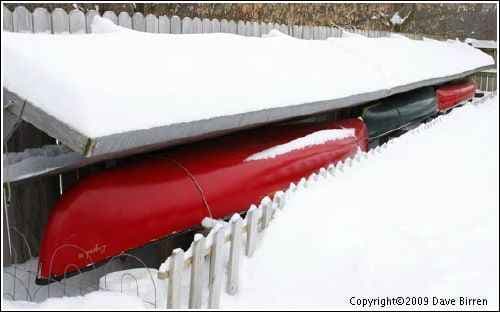

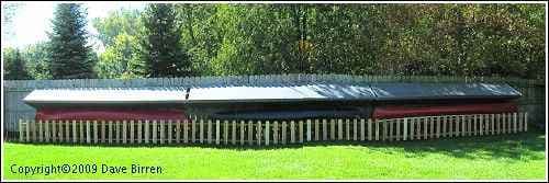

The canoes rest on simple wooden Ts. A long shed roof supported by sturdy dimension lumber keeps snow from weighing them down, while fences—wooden ones on either side; wire ones at the ends—hold the winter drifts at bay (not to mention protecting seats and thwarts from dogs looking for something to chew on). Is access a problem? Nope. The low wooden fence in the foreground is made up of six sections, and the fence posts are fitted into 2-inch PVC pipes sunk into the ground. Each panel is easily removed as needed, while tie-downs protect the sheltered boats from being whirled away by the Old Woman's wrath.
Want more details? This fall photo reveals all. Now you can see that the shed roof is formed by tarps, laced to a wooden frame with quarter-inch braided nylon line. Each boat has its own tarp, and each tarp is supported by three trusses, all sharing a common fascia. The tarps are lashed to stringers on the high back fence, and the lashings run through eye-bolts spaced about one foot apart.

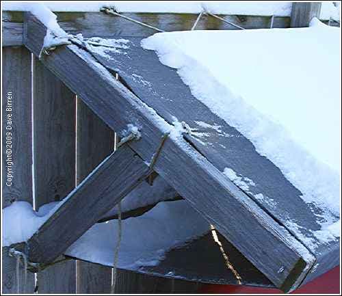

Now here's a close-up of an end truss, built from two-by-fours:

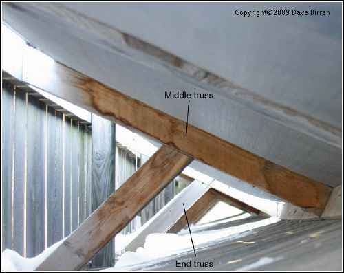

Note how the tarp wraps around the fascia and continues back to the high fence, forming a sort of soffit, as illustrated in this photo of a middle truss:
The result? A double roof, with each component angled to facilitate runoff.

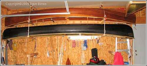

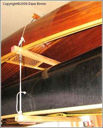

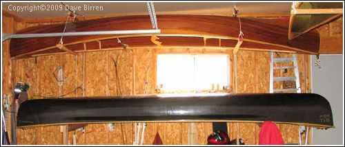

This is a view of the left-hand wall of the garage. Cradles cut from two-by-two lumber, suspended on 5/16-inch line, support the topmost boat, a beautifully finished cedar-strip tandem. Blocks (aka pulleys) make raising and lowering the boat a snap, while cleats secure the bitter ends of the lines—or "lifts," as they probably ought to be called. The lower boat can also be hoisted high, slung in a second set of cradles hanging from eye-bolts on the underside of the first (see next photo). In the photo above, however, the second boat rests temporarily on supports. These have pivoting wooden arms that fold against the wall when not in use. Now here's a picture showing both canoes up in the air:
Snap-links at the top of the lines supporting the lower cradles make hanging them an easy job. Let's step back and admire Dave's handiwork from a distance:
OK. That's five boats down…er…up: three under wraps outside and two inside. But that still leaves four more. Here's the next chapter in Dave's storage story:

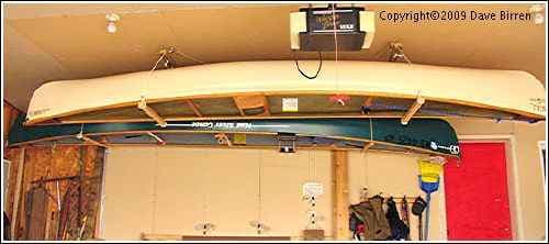

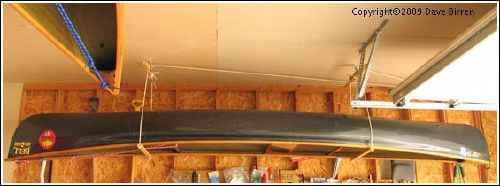

Two canoes hang side by side at the back of the garage, hoisted high enough to ensure free and easy access to the door and the storage space along the wall. (A third boat, not shown in this photo, now nestles in the narrow space between the garage door opener and the light fixtures.) And where is the last boat? Along the right-hand wall, of course!

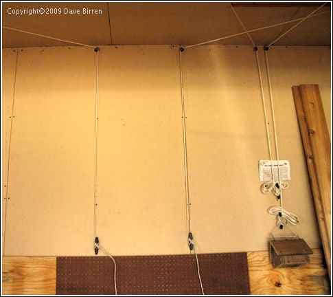

This elegant craft (a Bell Wildfire) hangs above a pegboard—out of the way but easy to get at. The key? As before, it's Dave's ingenious system of lifts, cleats, and blocks, a fine example of the rigger's art and one that would be the envy of any tall-ship sailor.

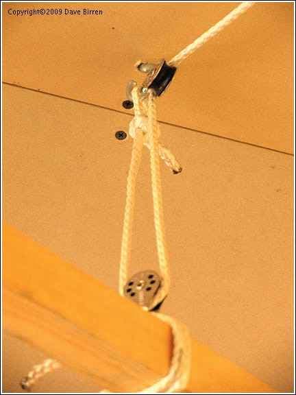

Now here's a close-up of one cradle and its lift. The blocks are Ronstan® pulleys, each one rated to 170 pounds. This isn't a place to cut corners. When you're hoisting a prized boat high over your head, it's better to be safe than sorry.

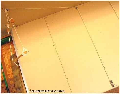

The short spreader above the cradle minimizes sway, while the tackles (see the next two photos) make the job of raising a heavy boat almost effortless.
The lift is made fast to a hook screwed into a ceiling joist, and the hook is angled so that the line exits the standing block—that's the pulley fixed to the hook—with a clean run to a turning block on the wall, high above the cleat. Take another look at the photo above. See how the lift runs from the hook through the running block on the spreader to the fixed block, and from there to the turning block and, finally, the cleat. This gives just enough mechanical advantage to insure easy lifting. It's the best kind of engineering: simple and good. You can't do better than that, can you?
