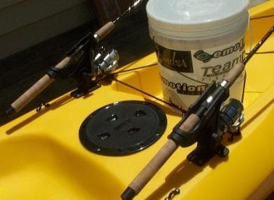

This is probably the easiest to install because, well, it simply mounts on the deck of your boat. Scotty rod holders are probably the most popular, but there are others that work just as well. They come in versions to fit either bait caster/spinning, or fly reels. They've very adjustable too. You can go with the deck mount bracket (which requires only 4 holes and 4 bolts) or the flush mount bracket (requires a hole to be drilled but installs with rivets). I'm partial to the flush mount bracket simply because it's leaves a nice flat surface when the rod holder is removed for transport. Here you see the flush mount Scotty with and without the rod holder.
These rod holders make for a very clean look. This type of rod holder when mounted behind the cockpit also gets the reels a little farther away from the water.
The deck mount version gives you a couple more inches of clearance off the deck, but as you can see, it will stick up during transport.
The best of both worlds here is to get the Scotty flush mount bracket and an extension - brilliant!

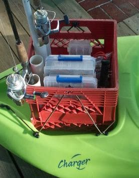

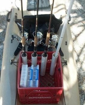

When I first got in to this sport, I decided I'd never be one of those people that used a milk crate for storage or adding PVC rod holders. Never say "never". Grab a milk crate, 10' of PVC, a little cutting, some fasteners, and my friend, you're fishing ! This also a slick way to haul all that tackle you feel you must have. Since these pictures were taken, I've added store bought rod holders and some other gadgets to my milk crate, but the idea is still the same. It's simple, it's effective, and it's cheap - I rarely leave home without it.
And by the way, you don't have to sneak around the back of a convenience store and "liberate" milk crates anymore. You can buy them brand spanking new from numerous places on line, in every color of the rainbow.
