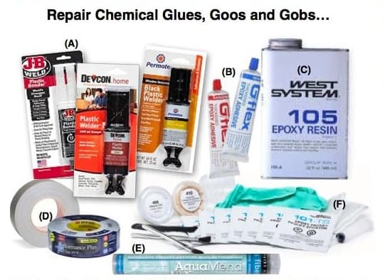

Kayak Repair Chemicals and Materials
(A) Plastic Welders/ Thermoform (B) G-flex/ Rotomold (C) Epoxy Resins/ Glass, Wood (D) Duct, Weather Seals, Marine Tapes (E) Underwater Epoxy Putty (F) Repair Kit

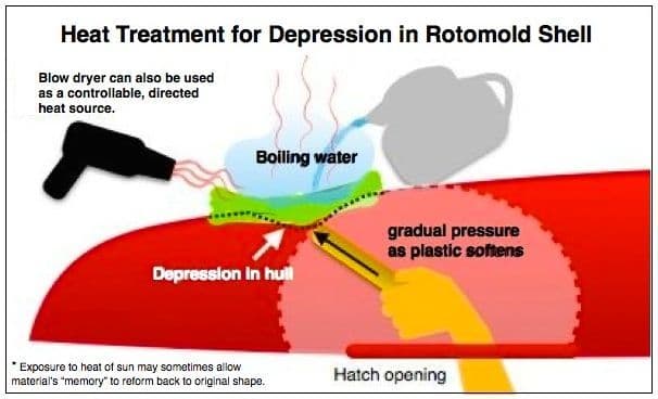

Two of the most common types of “damage” to a rotomold are scratches in the hull or pressure indentations (“oil canning”). Such depressions happen when a sun-baked or super-stressed boat tied too firmly to a rack caves in as the plastic is heated or stressed.
Quite often an indentation will diminish over time, using the plastic’s “memory” to regain its original molded shape. Sometimes, however, that depression needs a little help ‘remembering’.
Heat Treatment for Depression in Rotomold Kayak
Direct exposure to hot sun is often the simple way to expose the indentation to a softening heat source. Another easy method of removing an indentation is to apply heat above the depression and coupled with light, but direct blunt pressure from below.  I have found it necessary  - and quite effective - to use boiling water poured repeatedly over the indented surface until it softens enough to form it back into shape. A carefully rotated hot air flow can also be used to soften the plastic.
TIP: If using boiling water to soften an area, apply 2-3 layers of a terrycloth towel over the damaged area and pour the boiling water down through the towel instead of directly onto the surface.

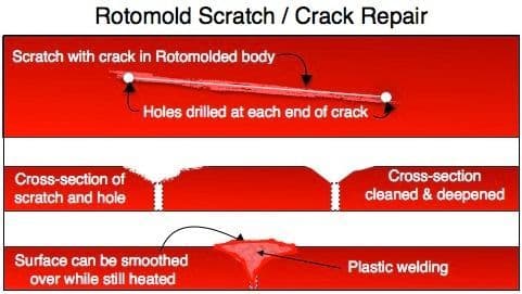

Rotomold Scratch/Crack Repair
Rotomold cracks can usually be repaired by “welding” the crack - sealing and filling the area with a hot welding gun/melting rods (NOTE: you cannot plastic weld cross-linked poly’ material). It’s a simple but somewhat delicate procedure in that too much heat can further damage the area around the crack.
TIP: To prevent the rare, but possible extension of the crack during handling, you can drill/melt a small 1/8” diameter hole at each end of the crack to prevent it from “running” farther along the surface. Start the weld just beyond hole, across and into the hole, and then follow along the crack as you apply heat.
Hot Weld a Rotomold Kayak
1) Blade expands crack as advanced ahead of hot weld 2) Hot melt rod starting just beyond hole, advancing along heated crack line. 3) 1/8" holes to prevent expansion of crack.
It’s important on any crack to clean up along its length and make sure the edges align. In some cases, it may be helpful/necessary to insert a thin blade into the crack to expand and expose it’s bonding edge, advancing the opening as you fill/seal the crack from one end to the other. Oftentimes patch work should also be done on the inside of the boat as well.
TIP: A relatively new filler material has been developed to adhere to rotomold plastic, as well as other materials - making it a quick and simple repair adhesive/filler for scratches, cracks and other repairs of all types of boat materials. NOTE: some “plastic weld” fillers do not adhere to polyethylene plastic).

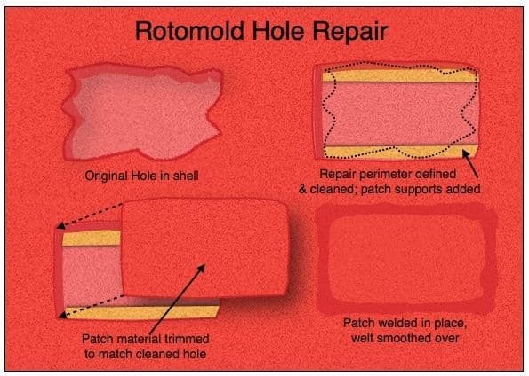

Rotomold Hole Repair
1) Original hole in shell 2) Repair perimeter defined & cleaned; patch supports added 3) Patch Material trimmed to match cleaned hole 4) Patch welded in place welt smoothed over
Short of deliberately forcing the boat down over a sharp spike or blasting it with a shotgun, I can’t imagine a rotomold getting a hole in it - other than perhaps a tiny, pin-head puncture. You’d more likely create a hole by concentrating too much heat into too small an area with your welding iron or hot air blower!
That said, the best fix for a hole is to smooth out and simplify the edges, get a material/color patch cut to size, perhaps add wood supports to the underside of the hole edge and glue/weld the patch into place. This might require some  professional expertise and may very well leave your boat severely scarred for life - so you better have a good story ready.

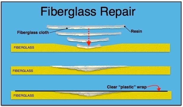

"Glass” Cloth Construction Kayak Repair
Shallow scratches can be accepted as is, others can be lightly sanded and/or simply coated over with resin/gelcoat. Deeper scratches should be cleaned and in some cases further routed out a bit to provide a more uniformed bonding area for filler adhesives.
Fiberglass Kayak Repair
It is generally best to mask off the area immediately around the scratch with blue paint trim tape, clean and even slight abrade the surrounding area before applying the repair coating.
TIP: (1) If you’ve taped around the repair area when using epoxy resin to coat over a scratch, remove tape while epoxy is still tacky to the touch, or else your new “repair” will be trying to remove hardened tape from your deck.
Full hull-breaching cracks in fiberglass, wooden and thermoform boats is significant damage. In the case of the fiberglass/thermoform boats, I’d suggest checking with a boat marine repair shop for the former, and with the manufacturer for the latter.

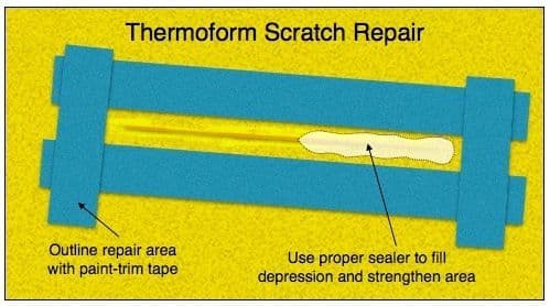

Thermoform Kayak Repair
The adhesive/resin used to patch Thermoform surfaces can be used either as a scratch filler or as the fiberglass cloth binder when used to repair damage from the inside of the shell. Eddyline’s website recommends Devcon Plastic Welder for both types of repairs. The particular application follows the routine for filling in most cuts and scratches as well as layering cloth to repair larger/deeper damages.

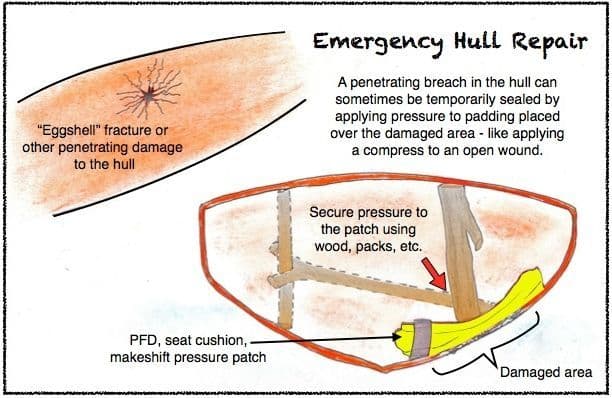

Emergency Kayak Hull Repair
A Penetrating breach in the hull can sometimes be temporarily sealed by applying pressure to padding (Such as a small pack or a spare PFD) placed over the damaged area - like applying a compress to an open wound.
Typically most damage while on the water first manifests itself as a small leak; water slowly collecting inside the boat. Most often these are caused by either a sharp, piercing impact that completely penetrates through the hull or a deep abrasion that breaks through the inner surface of the hull. Oftentimes these are along the bow or stern keels or directly under the seat in the cockpit. A quick fix on shore can be as simple as a piece of patch tape or even underwater-curing, two-part marine exopy putty.
TIP: Michael Gray, whose Uncommon Adventures paddling tours uses kayaks in a variety of environments all over the world, says that weather seal tape is a better choice than duct tape for quick sealing holes and other leaks in a kayak.
I’ve used both methods and they each work quite well, at least to get you back home or into camp for the day where you can do a better fix. Both tape and putty can actually be used for on-water repairs - literally accomplished by hauling up the damaged boat onto a “rescue” boat in the classic “T-Rescue” formation and completing the repair. In the case of the putty,  it can be worked and applied underwater, perhaps while floating in the middle of a bed of seaweed. It sets in about 20 minutes!
