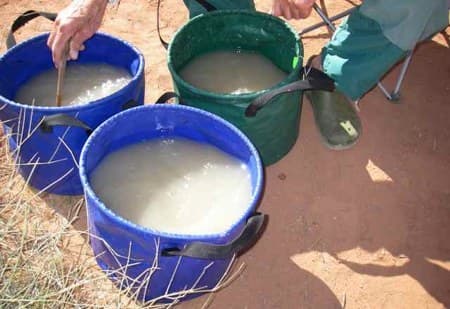

  1. Fill your bucket with the silty water.
  2. Add about a tablespoon (the measurement isn't critical) of alum per gallon of water.
  3. Use a long stick to very slowly stir the water. Stir in ONE DIRECTION only. Continue stirring until a "flocculant precipitate" (it looks like snow) forms on the surface of the water - it takes about five minutes.
  4. When you see the snow-colored precipitate, STOP stirring. Allow the water to settle for about 20 minutes. At the end of this time the water will be clear and the silt will have settled to the bottom.
  5. Use a Sierra cup or ladle to gently dip the clear effluent from the top of the bucket. You can now boil, filter or chemically treat this water to make it potable.
