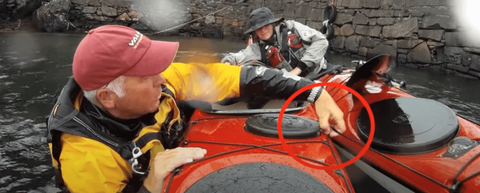

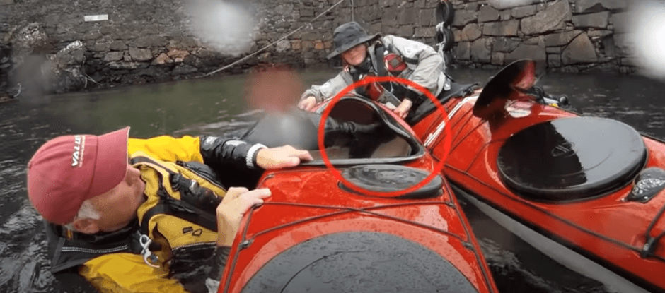

So when I'm in the water facing the kayak, I'm going to take my leg at the front of the boat, which is my left one, in this case, and hook it into the cockpit.
Hooking Heel into Cockpit
My left arm, then, I'm putting across. I'm holding my deck lines or my rescuer's deck lines or them both. The idea for that is to pull the kayaks together.
Left Arm Across to Hold Deck Lines

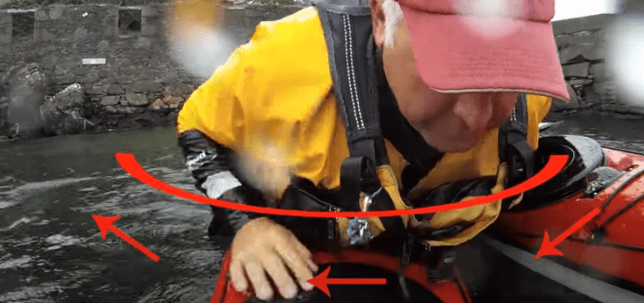

And then using my leg and my arm to pull myself and lean myself onto the back deck. My other leg goes in and then continuing the twist around, sit up and pop the spraydeck.
Pull myself up and continue the twist back onto the back deck
