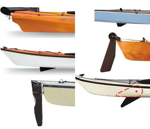

Kayak Rudder or Kayak Skeg?
Rudder? Skeg?

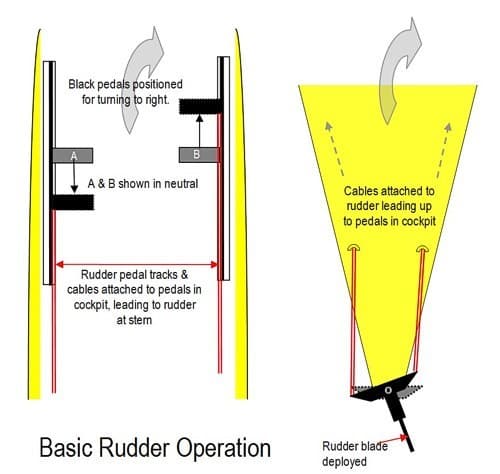

rudder is a long, narrow fin-like blade that extends down into the water off the stern end of a kayak. It can be moved side to side thereby affecting the flow of water along the blade, applying a force to the blade that turns the boat in the direction of that force (rudder angled to the right, boat turns to right). A rudder is designed to be deployed fully, and can be swept side to side by operating foot pedals in the cockpit.
skeg is a fin that is centered on the keel of a boat, either fully back at the stern or slightly forward of the stern – along the aft section of the keel. Some skegs are retractable (swung up and housed within the hull when not deployed); others are incorporated into the design of the keel. A movable skeg can be deployed part way or fully up/down - but not sideways.

Basic Rudder Operation
There are times, however, when a rudder actually is used to steer the boat. Kayak fishing often necessitates drifting into area to cast in a particular direction. Hands-free maneuvering of a drifting kayak is achieved by steering using the foot pedals to move the rudder as needed. Using binoculars or a camera while drifting benefits from the steering advantage of a rudder system as well.

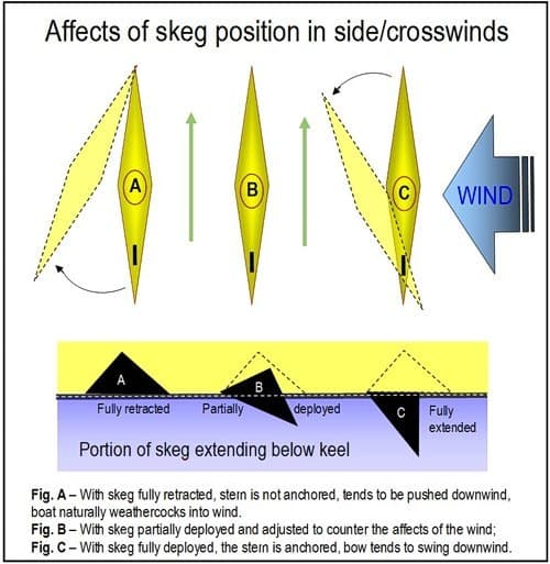

Affects of Skeg Position in Crosswinds
The use of a skeg is predominantly for anchoring the stern against side force influences. The extent to which a skeg is deployed – the amount of fin surface exposed beneath the keel – affects the resistance or force the stern has against being pushed sideways. Retracted skegs offer no resistance and thus tend to cause the stern to swing off line from the bow. Conversely, a fully deployed skeg can anchor the stern more than the bow, causing the bow to swing. Varying the amount of exposed skeg therefore affects those movements proportional to the exposed surface area of the skeg.
Affects of skeg position in crosswinds

Rudders are operated by a cable and foot pedals system. The cable, attached to the rudder, runs through a tube opening in the aft deck, through a channel and is connected to a foot pedal or sliding track in the cockpit. The cable is on a U-shaped loop: push forward on one side, the other side moves in the opposite direction. Pushing right, pulls the cable on the right side of the rudder causing it to swing to the right, and ultimately making the kayak go to the right as well. Simple and direct.

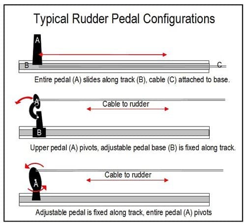

The trade-off comes from the softness in the foot pedal, a spongy feeling that compromises a solid contact point while paddling. The paddler can't get a solid foot brace with a non-firm pedal. This limitation has been addressed by the development of a "gas pedal" style of rudder foot control. It enables the base of the pedal to be fixed at a proper length for the individual paddler but the rudder cable is attached to a movable portion of the pedal enabling the paddler to have a solid foot hold and still be able to manipulate the rudder cable. "Gas Pedal" rudder systems offer a pedal component that is fixed in place, but either a portion of the pedal or the entire pedal itself also pivots to operate the rudder via the cable connection. This affords the paddler both solid foot bracing support and a movable rudder pedal.
Typical Rudder Pedal Configurations
