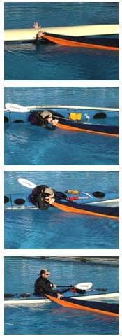

When you capsize, and your partner is near enough to assist you (and they know this recovery method), this is what to do:  Lean forward as close to the front deck as possible.  Reach both hands into the air, one on each side of your kayak. Your paddle can stay between your arm and your kayak.
When you first go over bang on the bottom of your kayak to get your partner's attention. Then keep your hands up in the air moving them forward and backwards along the side of your kayak. Be sure to keep you hands off of the kayak to prevent your hands getting pinned and smashed by the oncoming bow of your partner's kayak.
The person assisting can come in perpendicular to your overturned kayak, on an angle or parallel. We will discuss the parallel method another time. The parallel method is sometimes called the Eskimo paddle recovery.
The goal of the assisting paddler is to put their bow into your hands. By moving your hands you can feel their kayak if they come in and just miss you.
When upside down you can easily get confused as to the direction from which your partner is approaching. That is why you keep both hands up and move them.
Once the bow is in your hand you will begin to pull yourself up. Then you bring your opposite hand onto the bow. When both hands are on the bow pull you head up and rest it on the bow.
This is a good time to take a breath since you have been holding your breath for a while. If you did run out of air before your partner arrived, you could come up for a quick breath and continue hanging. Pushing down with both hands on one side can give you the lift you need to get that breath. If you do try for that extra breath while waiting, be ready to protect you face and head from the oncoming kayak.
The next step is a basic movement for rolling your kayak. Instead of pushing on the bow and lifting your head, it is easier to right your kayak by using your leg and trunk muscles. The movement is commonly referred to as a "hip snap." If you look at the previous picture you can see the kayak laying over the paddler. The hip snap gets the kayak upright, then you bring your head up. Believe it or not, this movement takes less energy than trying to lead with your head.
Once the kayak is upright you can follow with your body with the head coming up last. Once upright you can look for your paddle which should be nearby if you started with the paddle parallel to your kayak floating between your arm and kayak.
As you can see the kayaker is now upright and they never had to wet exit. As mentioned before, the overall immersion time is much less with this recovery method as compared to one involving a wet exit.
