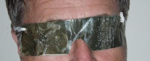

The first step is to take a 12" - 14" piece of 2" duct tape, fold it in half lengthwise and press the adhesive backs together.
Step two starts by finding the center of the strip and cutting out a nose notch, then measure equally out from the notch to the center of each eye. Mark each center for the field of holes you'll be punching through the tape.
Next, get a piece of wire the size of a large paper clip. In an emergency consider a large thorn from a locust or hawthorn tree. The more perfectly round each hole is, and the cleaner the edges, the better it acts like the lens on a pinhole camera.
You want to make a field of holes at least as wide and high as your eye is round. My pair has eight rows with about 10 holes in each row. The rows are about 1/8" across and the holes are about 1/8" apart. I staggered each row of hole just like the stars on the American flag are staggered. I used the heated tip of a large needle to make the holes quickly and cleanly.
There are many materials out of which this eye strip can be made. As long as you can create rows of uniform, clean-edged holes, you can use anything stiff enough, yet pliable to be worn as a mask over the eyes. Doubling a strip of duct tape back on itself gives you a perfect thickness to create these glasses.
You then tie on a piece of string or shoelace to each outside corner of the "glasses" and then tie the mask in place across your eyes. Finally, adjust the ban so each eye can look directly out through the field of small holes. Once in place you should see things clearly although you might have little halos around images and other visual "ghosts" but they are clear enough that you can read what would otherwise be quite blurry.
