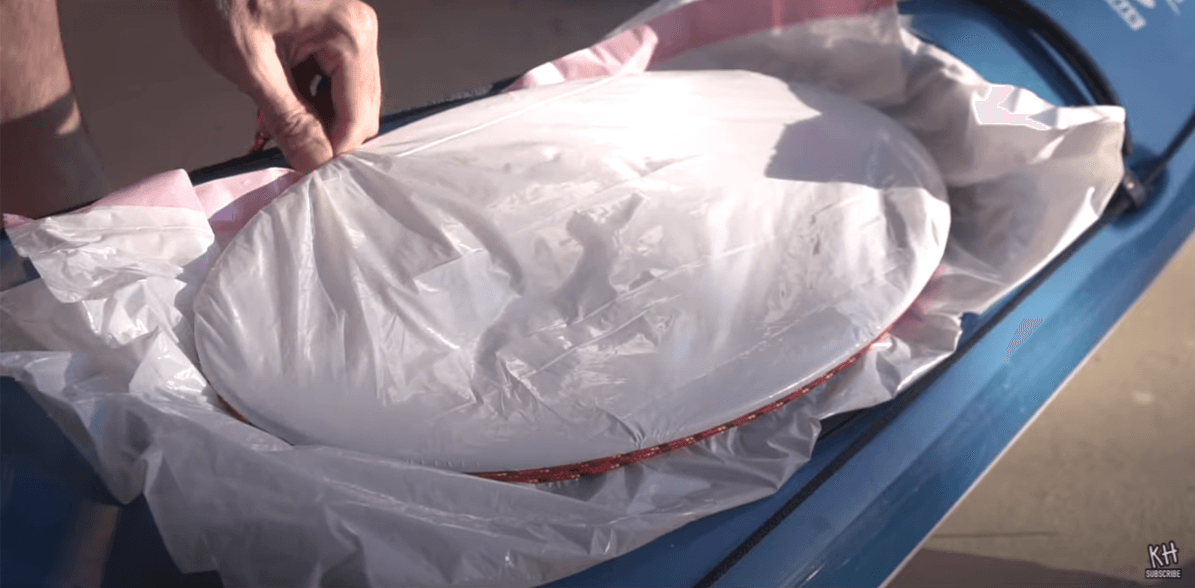

They might not be a hundred percent watertight, but they're pretty darn good. I have seen friends and fellow instructors that will use other options instead. In their repair kit they'll have let's say a plastic bag or a piece of tarp or some kind of material that will be watertight and big enough to fit any of the hatches and then they'll back that up with either gorilla tape, duct tape, or just paracord. So for example, what you can do is you put it over your hatch, you seal it up as best you can, close it up and then hopefully that's good enough to get you home.
Emergency Kayak Hatch Cover
What's really good about having a thick trash bag in your emergency kit is that if for some reason you also need to pick up garbage or something happens and you need to take that home, bags of that type are useful for many things, and a backup hatch cover would be one of the uses.
