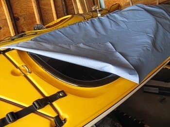

First, a tracing of the coaming is needed to be marked out on the fabric. So, lay the fabric good side down over the cockpit (so markings stay inside).
Next, wrap shock cord to make a snug fit. Leave at least 4" allowance (extra fabric) all around.
Fabric held in place with shock cord.

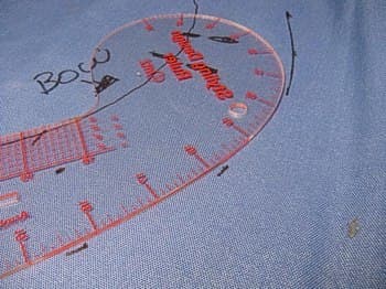

This next step was fun. Using a designers curve, I made marks 3 inches away from the original tracing and connected the marks to create the cutting line (a good job can be done freehand without the tool, too). Inside this border is where the buttonholes and 1/4" final hem will be made to prevent fraying.
There are two curves in this pic, the one in the upper left is the cockpit tracing and the plastic tool is lined up on the cutting line.

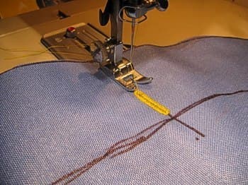

After cutting out the pattern, I made marks every several inches to spot where to add buttonholes. These locating dots for buttonholes were placed one inch away from the original cockpit tracing. I added 30 buttonholes; add more or fewer to suit your cockpit size.
Making the first buttonhole on a vintage Singer sewing maching. After sewing the buttonholes, snip them open with scissors. The buttonhole look is nice and saves making a casing.
Hem Edge

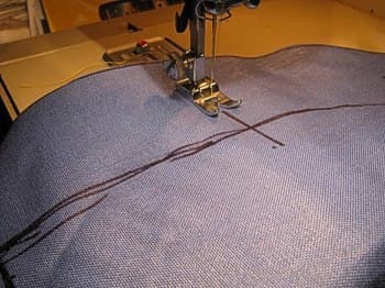

I switched to a console sewing machine to sew the 1/4" hem to prevent fraying, then threaded the shock cord through the cover.

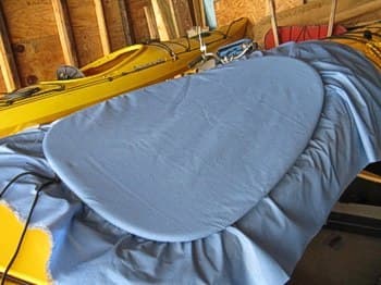

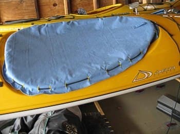

This picture is the cover being fitted, hem not yet done. The cord isn't tensioned hence the puckers...
Detail of cord exits; knot not tied. I cut the cord to length later and added aglets at the ends.
