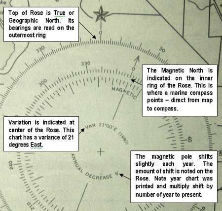

The Compass Rose & Compass Variation
The marine compass is used in conjunction with the compass rose printed on most nautical charts. Within the rose is vital information that directly translates to the use of that compass.
The outer ring on the compass rose represents true or geographic north (see the last article for details on how a compass works). On this outer ring, true north is 0 degrees/360 degrees. It is printed so that true North is at the top of the map. Since there is a variation from true North to where the compass needle actually points – called the Magnetic North – the compass needle or dial does not actually point to the true North Pole (except in very few places on the globe).
The next, inner ring on a nautical compass rose is a second ring of 360 degrees but it is turned slightly to represent the amount of magnetic variation in that particular area covered by the chart. That amount of variation is printed in the center of the rose. If you compare it to the outer ring you will see that “North” on the second ring has been rotated east or west the number of degrees of variation as indicated on the rose. If, for example, the variation for the area, as shown on the rose is 12 degrees East, the North point on the second/inner ring (magnetic north) will be 12 degrees further to the right (east) than the actual True North point.
Here’s the simple beauty of using a compass with nautical charts. Charts are designed to be read using magnetic bearings. The inner ring allows you to determine all the magnetic bearings of landmarks and such so you can read directly from map to compass – and back – without having to make any adjustments or do any math.
Sweet, eh? If you determine, from the map that a point of land is 75 degrees (based on the inner ring) from where you are, that’s the bearing you can use – without making any compass adjustment for variation or true north.

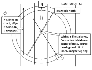

An easy and accurate way of determining what bearing you must take to reach a desired destination is to mark that course line on a piece of tracing paper and then transferring that line to the compass rose:
1. Determine the course you want to take. Mark it on your chart (A – B on illustration #1).
2. Using either tracing paper or a sheet of acetate, transfer the True N-S line and course line to the sheet.
(Illustration #2)
3. Take the overlay with your course and the True N-S line and lay it over the top of the Compass Rose that is printed on the chart.
(Illustration #3).
4. Make sure that your True N-S line is parallel to those on the chart; then move your overlay around until the course line goes through the center of the rose. Keeping it on center, maneuver the course line until the tip of it intersects the inner ring of the Rose (the inner ring is the magnetic bearing ring. Illustration #3).
5. The bearing indicated on inner ring is the compass bearing to follow to reach your destination.
