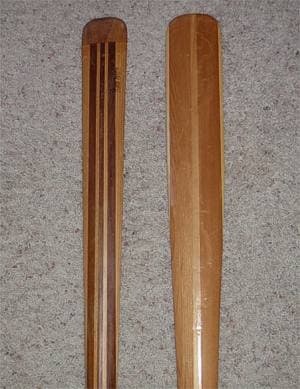

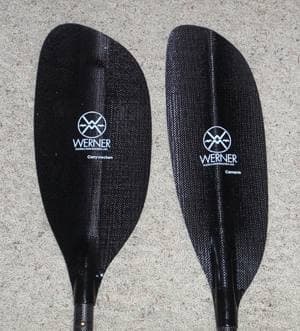

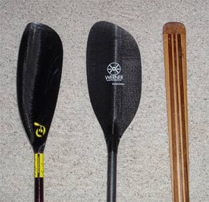

I decided to compare three different paddles. My Tuktu Greenland paddle (Tuktu eight feet long x 3 & 3/8" wide), my big blade paddle (Werner Corryvrecken) and my wing paddle (Epic mid size wing). I felt these three paddles would give me a great comparison since they represent three different styles of blade. The narrow Greenland blade, the wide blade euro-paddle and the racing blade give a fair representation of the different blade styles. As a side note, I have previously determined that my top speed with a euro-paddle was with my wide blade paddle compared to two different euro-paddles with narrower blades.

My top average training speed with my Greenland paddle was 5.7 mph.
The next higher pace was with my big blade euro-paddle at 5.9 mph.
The highest average pace was 6.1 mph with my wing paddle.
I was seeing an increase of 3% to 4% by using my wing compared to my wide-blade euro-paddle. As I mentioned early, I was told that wing blades could increase performance 3% to 5% and my increase was 3% to 4%.

It is also important to note that just because the Greenland paddle was 4 tenths mph slower than the wing paddle, it doesn't mean it is a slow paddle. Remember, I was comparing racing speeds. Since the common average touring speed for most sea kayakers is 3.5 to 4.5 mph, anyone using a Greenland paddle would have no difficulty in paddling with the group or even sprinting ahead.
Since all Greenland paddles are not the same, I also had a wider Greenland paddle made for me. The wider Greenland paddle (4" wide) increased my Greenland paddle time by 1 tenth mph. However, it definitely added more stress and I had to work harder.
