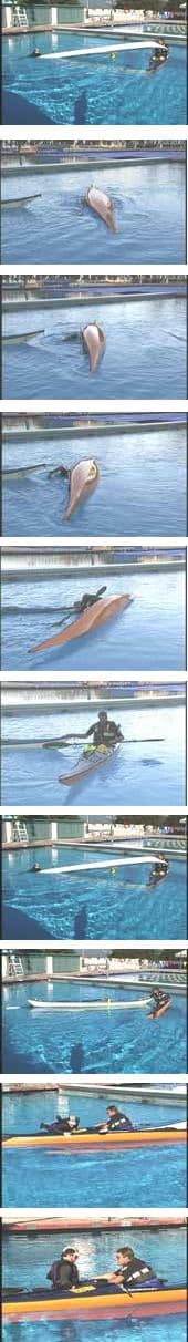

Here I am helping to drain the water from my partner's kayak after they capsized. Let's imagine I loose my grip and balance while in this position and I end up capsizing. First thing to do is to protect your head from banging into the kayak you just dropped. When practicing this skill fall toward the kayak you are draining while keeping your hand on the bow so you can keep your head clear of it.
Now you are upside down with your goal being to get the other kayak back into your grips so you can recover yourself without wet exiting . When you are back upright you would reinitiate the T-Recovery.
Swimming while in your kayak is a great skill to have in your bag of tricks. While upside down turn toward the side where you see your partner's kayak. You have a choice of side stroking to your partner's kayak or doing a dog paddle. If you dog paddle rotate your torso so your chest is facing the bottom and your back is toward the surface.
Swim towards the other kayak. If you need air along the way you can push down with both hands to provide lift so you can get a breath of air before you continue swimming. When this type of dual capsize occurs the other kayak is usually near by. On windy days the other kayak can quickly move away so you need to start your swim immediately. It is important to keep yourself braced into your cockpit when swimming with your kayak. It is easy to slip out if you do not brace yourself in with your knees and thighs while pressing on the foot pedals.
The most difficult part of this skill is finding the other kayak when you are underwater. We easily get turned around when we capsize. If the kayak started on my right side before I capsized I need to be coming up with my left arm leading. That is why I like to practice this skill by falling toward the kayak as I drop it. Eventually you should practice falling away from the kayak you are draining so you can practice orienting yourself.
As in all planned submersion practice sessions, I recommend you use nose clips and/or a dive mask. If the water is very cold use a hood. Once you learn how to find the other kayak then take off the mask. Then keep practicing with nose plugs. Eventually you will want to try it as it will normally occur: free from nose clips. It is always good to be as comfortable as possible when you are first learning the skills. Once you have the orchestration of the skill mastered in controlled and comfortable conditions, then start simulating real life conditions.
Once I get to the bow (or any other part of my partners kayak) I lift my head to my hands (which are now out of the water) and I take a few breathes. Then I right myself by righting my kayak underneath me. I bring my head up last to reduce strains. I am simulating the same action we use in bracing and rolling when I right my kayak.
Now that I am upright, I can continue with draining the water from my partner's kayak. Most likely the cockpit refilled when I capsized and it dropped back into the water.
