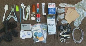

The Repair-Kit List (Rev. 13) The following is my own list of repair items I carry onboard when spending anything more than a day on the water. Like all my other lists, this one is constantly evolving as I reconsider and add certain items, or as my situation changes. Consider your particular paddling environments and assess your unique needs when putting together your own "possibles" bag.
What do you carry in your fix-it kit? Tell us in the Comments below!
Part 1 Carried in deckbag, cockpit, or dayhatch, for making on-the-water repairs
  • Emergency Hatch Cover: Heavy-gauge Polyethylene Sheet, 28 x 28", and Shock Cord, 3/16 x 4', with large Cord-Lock
  • Pack Towel, 6 x 6"
  • Duct Tape, 10', 3M or other quality brand, wrapped around old plastic hotel room key-card
Part 2
Carried in waterproof container, somewhere secure, for all other repairs
Tools: • Screwdrivers: Phillips & Standard • Small Adjustable Wrench • Needlenose Pliers w/ sidecutters • Multi-tool • Hacksaw Blade, short section • Butane Lighter • Sandpaper, assorted grits, small pieces • Plastic Gloves • Eyeglass Repair Kit • Spare Dining UtensilsMisc. Hardware: • Stainless Steel Nuts & Bolts • Deck Cleats w/ Screws • Misc. Strap Buckles • Tent Pole Repair Sleeves • Parachute Cord, 1/8", 20' • Heavy-gauge Braided Polyester Fishing Line, 10' • Shock Cord, 3/16 x 4' • Perimeter/Deck Line, 5' • Monofilament Nylon Fishing Line, large and small, 10' • Skeg Cable or Rudder Cable w/ Crimps • Rudder Pivot Bolt w/ Locknut
Supplies: Alcohol Swabs for drying/cleaning damaged areas Superglue 5-Minute Epoxy Small Fiberglass Repair Kit: 8 oz. polyester resin, .20 oz. methyl ethyl ketone (MEK) hardener, plastic spreader, 3 sq. ft. fiberglass mat Epoxy Putty, marine-grade Duct Tape, 10', 3M or other quality brand, wrapped around old plastic hotel room key-card Urethane Adhesive Self-Adhesive Nylon Fabric Patches, assorted sizes Sleeping Pad Repair Kit: Patches, Adhesive, Tape Heavy-gauge Polyethylene Sheet, 24 x 24" Assorted Needles & Safety Pins Copper, Brass, or Aluminum Wire, 5' Cable Ties, assorted sizes Silicone Grease 3-in-1 Oil
