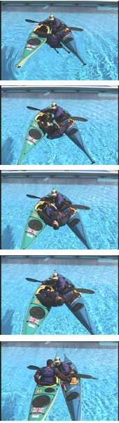

Once you are ready to get back into your kayak I recommend your partner hold your kayak steady in the bow to stern position. You have given your paddle to your partner if it is not on a leash. You need to be between the two kayaks by the back of your cockpit. You want to put one arm up on each kayak (shoulder concerns will be discussed later.)
Your goal is to place both of your feet into your cockpit. Tilting your head back makes it easier to get your feet up.
As you can see the partner trying to hold your kayak needs to be able to stabilize your boat and still leave space for you to get between them. I have seen this as a challenge for shorter paddlers.
When ready, press down with both arms, arch your back and slip into your cockpit. I have to say it is a beautiful sight to see when it is done correctly. It is also very painful to watch when someone cannot arch their back to slip in. The idea is to slip your backside into the seat by going over the back coaming and the seat back. That is why arching the back is the key to the skill. Once your backside is in the seat the rest of the body follows.
