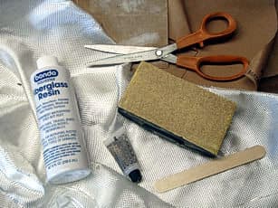

Materials
NOTE: I don't have the space nor the in-depth expertise to go into the details of working with resins and fiberglass cloth - those require "hands-on" shop practice to even minimally master. If you are going to attempt the more complex repairs cited herein, take the time to practice mixing and applying these materials before you attempt to repair your valued gear. While there are no style points involved, a clean repair is a lasting and even safer repair.
  • Paddles & Shafts - Typically blades are either wood (mostly canoe) or a variety of materials including plastic, fiberglass and graphite (mostly kayak). Shafts are made of these materials as well as aluminum.
  • Adhesives, coatings, etc. - Glues, resins (epoxy, [poly]urethane, methacrylate), marine spar varnish. Here's a brief overview the most common ones:
Epoxy - better mechanical strength, better adhesion, better water resistance than poly (see below). The epoxy resin must be mixed precisely with a hardener and must dry thoroughly before sanding - which is necessary to do between each layer in a multi-layer application. Epoxy adheres to wood, metals, cured polyester laminates, vinylester laminates, epoxy laminates and "extremely well to graphite fibers" according to West System literature on these adhesives. PC-Marine also makes a hand-moldable epoxy putty for "quick, emergency-like" repairs.
Polyester Resin/Urethanes - Often referred to as "boat resin"…it is mostly used for fiberglass repair. It's cheaper than epoxy and because the surface doesn't totally cure, layers can be added without the need to sand between applications. Surfacing agents and hardeners can be added to finalize finishes for appearance and strength.
Sterling Donaldson of Sterling's Kayaks is the renowned "Chemical Man" to colleagues in the kayak industry for his knowledge of resins and their applications. Sterling offered several tips about using poly and epoxy resins. "Stay away from the packaged stuff!" warns Sterling when it comes to buying epoxy off the rack.
First of all, he says epoxy works best if repairs are made with the same kind of resin used initially. Also, if claims are made that it dries within ten minutes or less, "it's not really epoxy," he says. "They won't hold up in water, it will yellow and it's not long lasting." Cure time is also very important for most resins so follow instructions for their mixing carefully. Urethanes also tend to weaken at higher temperatures.
Methacrylates - I am not familiar with this product - It may only be an industrial use product. It's advantages over poly or epoxies are claimed to be excellent impact resistance, good gap filling, excellent peel and shear strength, good flex' at low temperatures. It is apparently what Eddyline uses to build their entire boat.
Other glues - Of the many adhesives on the market, your best bet may be to go to a marine supply store for small repair kits or smaller quantities of bulk resins. Sterling endorses "Gorilla Glue" as one of the best adhesives to use on wood products.
