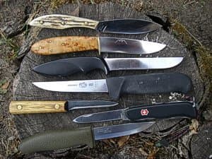

Quick! You're going on a wilderness canoe trip. Besides your paddle and PFD, what tool do you value most? If you said "a good sharp knife", you're in agreement with the experts. Most people use a mechanical device of some sort to sharpen their knives. This is fine as long as "moderately sharp" is good enough and you have space to carry the sharpening tool. Actually, it's easy to sharpen a knife to a razor's edge. All you need are the right tools and practice. This method works with any non-serrated blade.
SHARPENING TOOLS A medium-grit and fine-grit whetstone. You need a coarse grit stone only if the knife is badly nicked or very dull. The quality of the abrasive is more important than whether the stone is natural or synthetic. Indeed, Amazon natives use water-worn rocks to sharpen their machetes-and they obtain whisker-sharp edges. Use water to lubricate diamond stones and cutting oil or WD-40 on natural stones. For safety, your stones should be at least six inches long.
